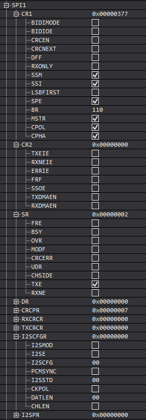

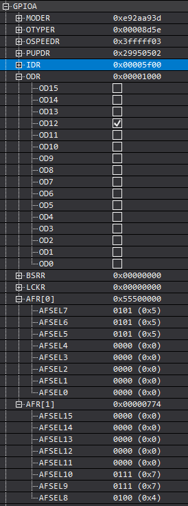

SPI register settings:

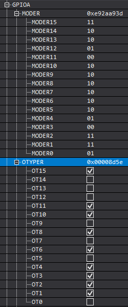

PIOA settings (pins 5 = SCLK, 6 = MOSI, 7 = MISO):

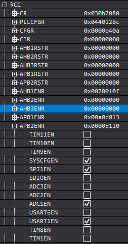

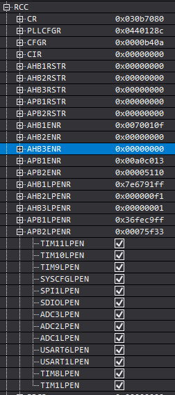

RCC register settings:
I've played around with the prescaler CLK phase and polarity. One note, CLK never idles HIGH with CPOL = SPI_POLARITY_HIGH.

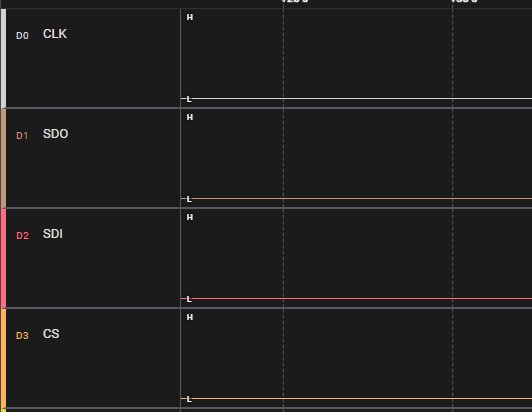

This is all I get when I am in master mode:
Also note, I am not wiggling a CS right now - just trying to see a CLK and some data.
When I build it in slave mode and send data to the chip I see nice wiggles in all the right places and the micro reads the data correctly and sends back data to the remote SPI master. When I am doing this mcu SPI master testing, I have the remote master device disconnected and just have the logic analyzer connected.

Are you sure you want SPI_CR1.BIDIMODE be set?
2023-05-24 5:38 AM
I tried it again with that cleared, updated the image and still the same results.

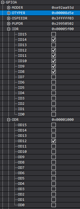

OK so set SCK to GPIO Output and try to wiggle it "manually" and observe.
2023-05-24 6:57 AM
I can't wiggle the old CLK and SDI. I can wiggle SDO.
2023-05-24 8:34 AM
What external device is connected to the SPI signals? Is whatever used to be the master still connected? If so, it is probably driving those signals.
