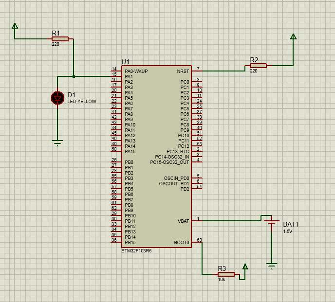

as far now im not getting any errors or warning in my program,but while simulating in proteus im not getting the output as per the program.Below is my proteus connection.Kindly help me to overcome from this.
2019-05-24 1:12 AM
Would this be a real-world circuit, the LED would blow as soon as you switch PA1 high. The resistor should be in series with the LED.
