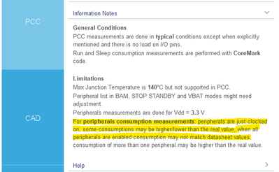

> If we go with the datasheet it is showing 541 mA at 125 degC Ambient Temperature when all peripherals enabled and 502 mA when all peripherals disabled while in CubeMX it is showing 171 mA which is significantly lower.
I think you need to read the datasheet more carefully.
Besides of junction temperature and core clock frequency, the VOS settings play an important role as well.
And, as pointed out with my underlining, these are not ambient temperatures.
