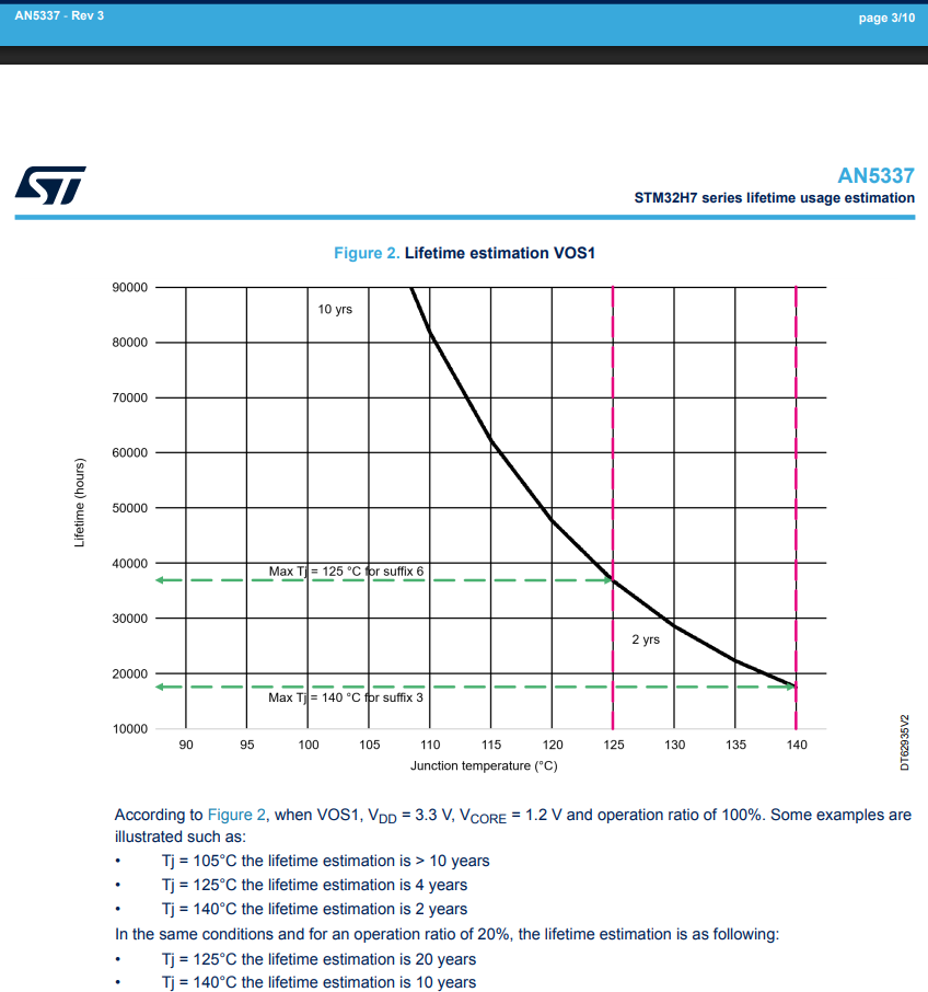

I came across this document here https://www.st.com/resource/en/application_note/dm00622045-stm32h7-series-lifetime-estimates-stmicroelectronics.pdf
We have a H75x custom board running the MCU in VOS1 at 400MHz with external 1.2V core power supply.
According to this description here
According to Figure 2, when VOS1, VDD = 3.3 V, VCORE = 1.2 V and operation ratio of 100%. Some examples are
illustrated such as:
• Tj = 105°C the lifetime estimation is > 10 years
• Tj = 125°C the lifetime estimation is 4 years
• Tj = 140°C the lifetime estimation is 2 years
In the same conditions and for an operation ratio of 20%, the lifetime estimation is as following:
• Tj = 125°C the lifetime estimation is 20 years
• Tj = 140°C the lifetime estimation is 10 years
the power consumption, heat dissipation and lifetime is influenced by "operation ratio". What does operation ratio mean and how can I influence/control it? Does this mean that only a part of chip silicon is powered/used? Or time spent in the idle loop, assuming the MCU is running in lowest VOS mode and/or clock frequency during idle time?
I would expect this term to mean the relative time of the system operating at given temperature.
Higher temperatures and higher currents cause electromigration (migration of n-/p- doping atoms), which degrades the die structures over time.
Mind you, these are all statistical measures.
And second, the key temperature here is Tj, not Ta.

So this:
https://www.st.com/resource/en/application_note/dm00622045-stm32h7-series-lifetime-estimates-stmicroelectronics.pdf#page=4
Indeed, the term "operation ratio" is vague and needs proper definition.
I guess it's some sort of "duty cycle": presumably, the 20% indicates the proportion of time operating at the high junction temperature - but what is happening in the other 80% of the time?
Presumably it would also depend on how long the high temperature is maintained?

If what I see from the internal temperature sensor is half-way close to the real Tj, then I am quite relieved with my typical application:
  • Tj is at about 15°C above Ta
  • single core running at 400 MHz
  • audio streaming via ethernet at about 25 Mbps mostly via DMA
  • CPU awake about 20% (checked quite precisely with CYCCNT)
Looking at the graph above and estimating Ta max of 50°C, this should work for at least 20 years. :D
