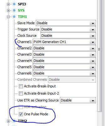

Some of the timers that contain multiple channels are supposed to be able to support a one pulse mode where a delay precedes the pulse after a trigger is received. However in CubeMX I cannot see how to set that up. Is that mode only attainable by altering the CubeMX generation after the fact with user code?
2016-08-24 4:55 AM
Hi greenwood.greg,
You just select the channel of TIMx and after that pick the ''One Pulse Mode'' from the TIMx menu on the bottom as showed in the figure bellow.2017-09-27 9:24 PM

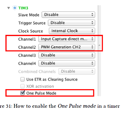

I'm trying to get this to work on a STM32F410RB nucleo board. So far without much luck. I know that you have to use Channels 1 and 2 on the timer. One of them will be configured as the input trigger and the other will be the output.
I've found this MXCube configuration and code in 'Mastering STM32' (sorry it's not in the code format. I'm not sure how that works with the '<>')
