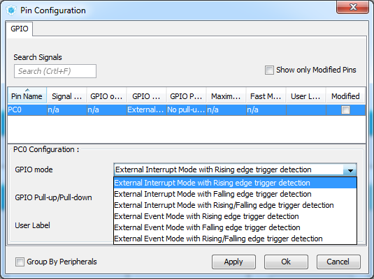

1. In Pinout tab of STM32CubeMX please click with left mouse button on the pin, which you want to configure. From the menu please select EXTI option. For example below I attached a picture, which shows how to configure PC0 pin as EXTI0.

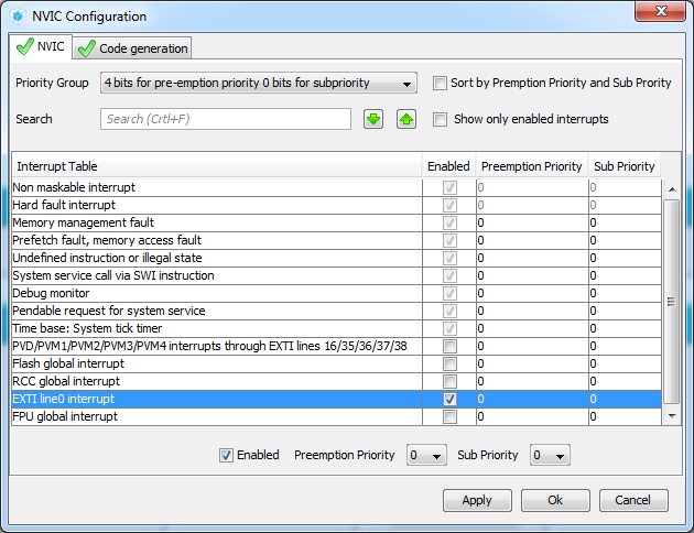

2. In Configuration tab of STM32CubeMX click on NVIC brick. As a result a window with available interrupts will be opened. From the list please enable EXTI line assigned to the pin. In our case it is EXTI line 0.
3. Optionally if you would like to configure parameters to trigger this interrupt, in the same tab (Configuration) click on GPIO brick. From the list select PC0 and you will be able to select for example edge of signal, which will trigger the interrupt.
