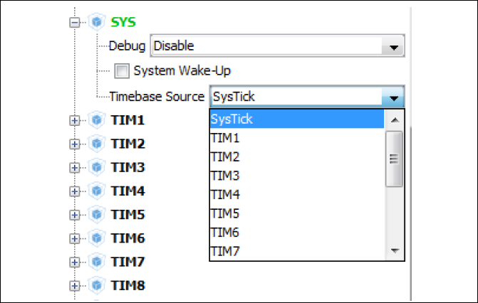

To change the HAL timebase source, go to the SYS peripheral in the IP tree pane and select a clock among the available clock sources: SysTick, TIM1, TIM2,...?
So you can select a HAL timebase source (STM32F407 example) as follow: ( note that the selected timer will be grayed and can no longer be selected)

I still have one question though : what timer should I select? In the UM, there are screenshots showing TIM2 selected. But is there any reason to select one time over the other for a very simple code?
Thanks for your help
Walid FTITI_O
Senior II
Posted on September 23, 2016 at 12:49
Hi de_wolf.christophe,
There is no restriction . Any timer can be used in addition to systick possibility.
have a good day.
