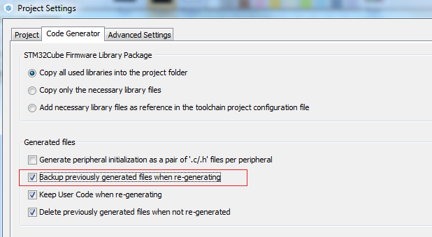

Nesrine M_O
Lead II
Posted on February 13, 2017 at 10:53
Hi
Castrignano.Adalgiso
Please try to set the
Backup previously generated files when re-generating option :
Backup previously generated files in a backup directory
The .bak extension is added to previously generated .c/.h files.
Keep user code when regenerating the C code.
This option applies only to user sections within STM32CubeMX generated files. It does
not apply to the user files that might have been added manually or generated via ftl
templates
-Nesrine-

Nesrine M_O
Lead II
Hi
templates
-Nesrine-
