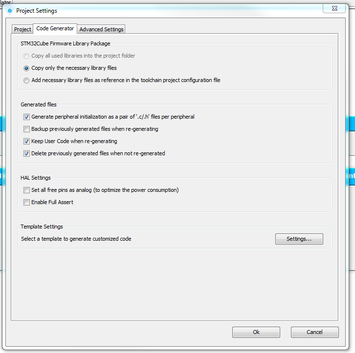

I can have Cube backup the files its going to overwrite.
It can recognized my code sections within a generated file, update the whole file and leave my code in new file.
It can figure out that i have removed a peripheral and delete the old files.
Is really too much to ask it not overwrite a file i mark as readonly in the OS after i add a workaround outside of user code sections?
Simple checkbox, check file protection before overwrite, if its READONLY leave it alone.

I found a problem in 'HAL_RCC_ClockConfig' function from 'STM32Cube_FW_F1_V1.6.0' firmware library
which I have to correct every time I generate code in CubeMX. It was so annoying. So, as a workaround I corrected function definition in firmware library itself as it is used by CubeMX to generate code. Now everytime CubeMX generates code with my changes in it. You should patch your changes in CubeMX firmware library itself. The location of firmware library can be found in CubeMX project settings.
