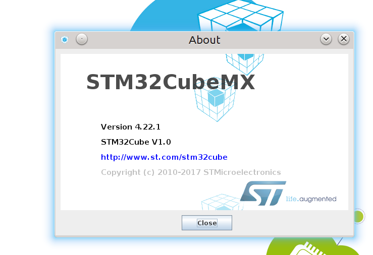

2017-09-13 1:40 AM
Well my usb_device.c still has the following generated contents (no user sections):
/* init function */ void MX_USB_DEVICE_Init(void){ /* Init Device Library,Add Supported Class and Start the library*/ USBD_Init(&hUsbDeviceFS, &FS_Desc, DEVICE_FS);
USBD_RegisterClass(&hUsbDeviceFS, &USBD_CDC);
USBD_CDC_RegisterInterface(&hUsbDeviceFS, &USBD_Interface_fops_FS);
USBD_Start(&hUsbDeviceFS);
Also the code generation fails with the following output (however this file got regenerated):

2017-09-13 8:53 AM
Hi
SIRY.Marc
Yes I am using the 4.1. I have updated it from 4.0 and using it on Linux if that matters.
Here you can find the ioc file:
https://www.dropbox.com/s/nje8srs0gfpoqas/xlineusb.ioc?dl=0
Thank you for your help!
2017-09-15 6:11 AM
After reinstallation of the CubeMX this problem solved. In the past I have only updated it.
