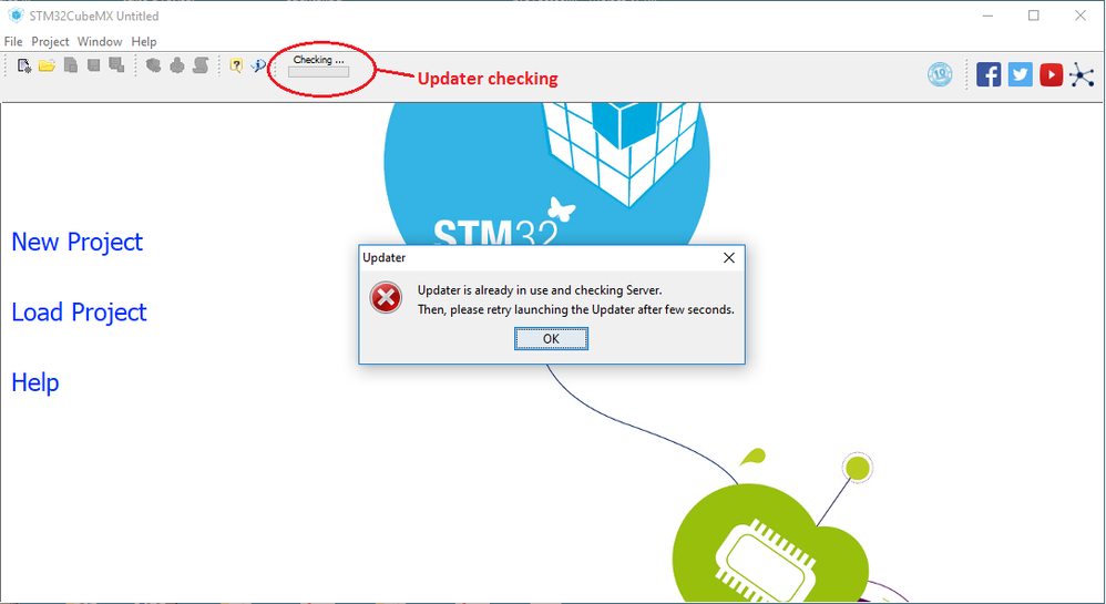

CubeMX pop up the message 'updater is already in use and checking server. Then please retry launching the Updater after few seconds'. It has been always checking and nothing updated. Because of that issue, there is no firmware available and it can't generate source code.
How to fix that issue?

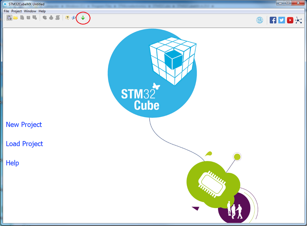

As an information, when you open CubeMX, the updater will check automatically the new updates. and here is updater job in background.
So, that's why when you try ,for example to change the updater setting, a pop up message appears. It's recommended to let the updater finish his checking until you get this new view below.

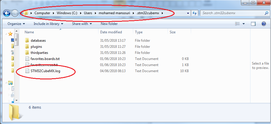

Finally, you can check your log file under this directory: C:\Users\mohamed mansouri\.stm32cubemx
