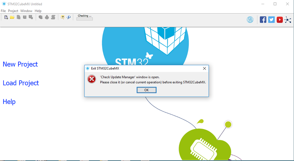

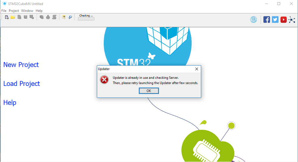

At start STM32cubeMX software version 4.25.1. It is not possible to disable the automatic update search. When i try to click on ?Updater Settings? appears the message ''updater is already in use and checking server. Then please retry launching the Updater after few seconds''.
This appears when i try to close the software.

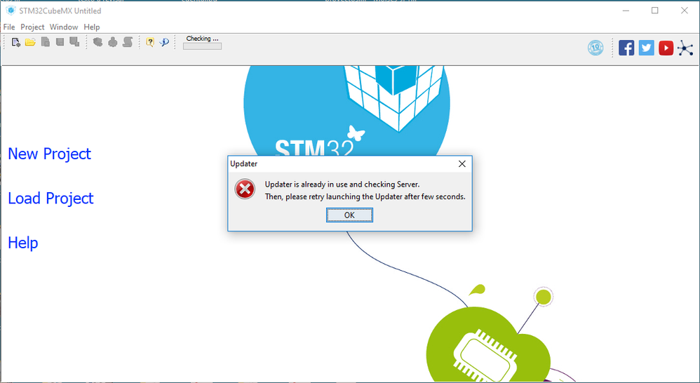

This appears when i click on ''new project'' option. This is very strange, because obviously i have a internet connection and i have added an exception in my firewall (just in case).
After i click on ''yes'' appears again the same message.

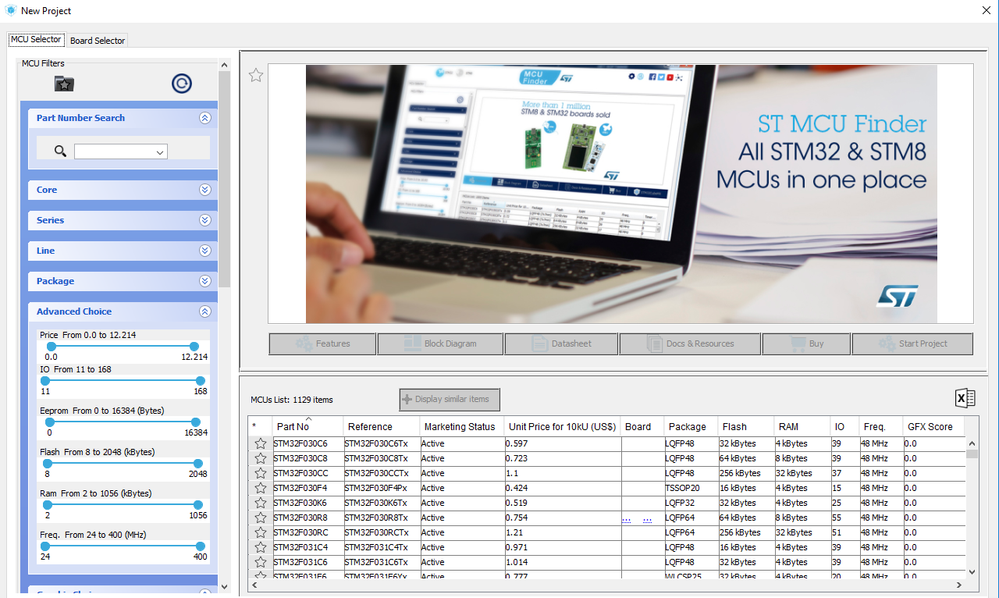

This situation happens two times and then i have access to this screen, but after 5 minutes it is impossible to work. My pc is absolutely frozen.

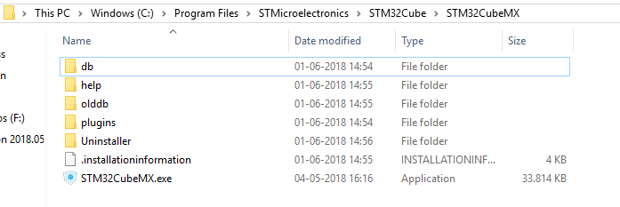

As you can see in the next screenshot, i have no .log file to share.
