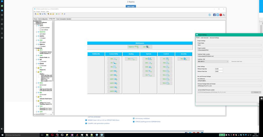

I can't migrate my project from 4.23 to 4.24. Attach is my ico file.

I play a little with your migrated *.ico file and i find out, you didn't have to change the prescaler in the CAN-IP than everything seems to work fine. If you change them and save the project you can't load it any more.
Edit:
I even play with my ico and find out any time I change the Clock Configuration or the CAN-Prescaler, CubeMx seems to hang!
So I thing there is any problem with time or clock calculation for anything in the CAN-IP.2018-01-24 8:16 PM
When I new a project(DAU1_4.24.ioc) in 4.24 that have the same config as the attachments(DAU1.ioc), close it than open it again, cubemx have no respond.
2018-01-29 9:19 AM
It seems to be a Problem with the CAN-IP! I have the same Problem an cube seems to damage my *.ioc.
I have play a little with my ioc and find it out.
Open your DAU1.ioc without migrating it! Then disable the CAN-IP --> save it --> migrate your project to newer version.
But caution! The CAN-IP Module seems to be damaged... -->https://community.st.com/0D50X00009XkhJCSAZ
....So do a backup.Now you can enable the CAN-IP.... But if you change any settings of the CAN-IP
will happen.So I think their is a Problem with, Time Quantum, Time for one bit or any other calculation.

You are right, we can reproduce the same behavior in CAN configuration on CubeMx 4.24.
This
issue will be fixed in next release.
Thank you for highlighting this issue and Sorry for the inconvenience it may bring.
Kind Regards,
Imen
2018-02-21 1:16 AM
Sorry for the inconvenience. This problem will be solved in next STM32CubeMX 4.25 release coming out in few weeks from now.
