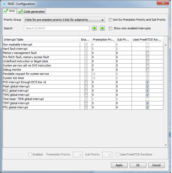

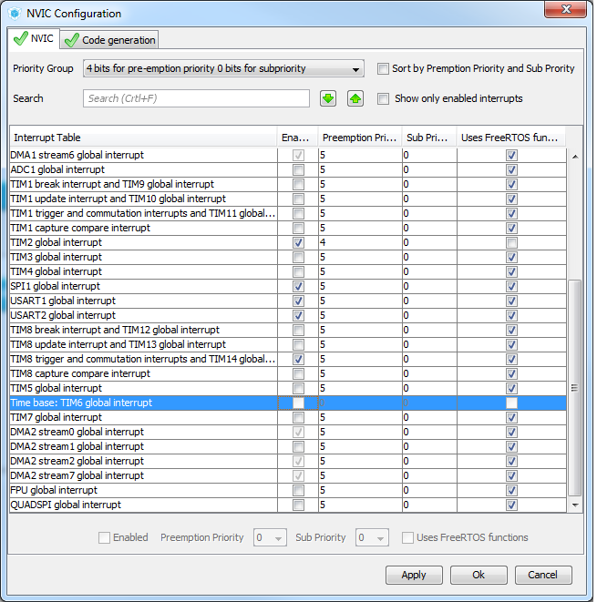

...but I failed to reproduce issue 1 there. The ISR is correctly generated. But I compared the NVIC-configurations of both ioc-files and found out that in the test-project the ''Enable'' checkbox is checked but in my project it is not... but since it is disabled (greyed out) I cannot change it mayself.
NVIC-settings of test-project:
vs. NVIC-settings of my project:

I could solve issue 1 myself by adding the following line in the ioc-file with a text-editor:
NVIC.TIM6_IRQn=true\:0\:0\:false\:false\:true\:false\:false
(copied from the sample ioc-file I attached here)
BR,
