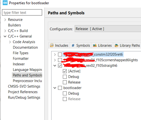

2021-06-17 3:15 AM
in app project preferences C/C++ General -> path and symbols -> references tab , need to be set for all project configuration
2021-06-17 3:29 AM

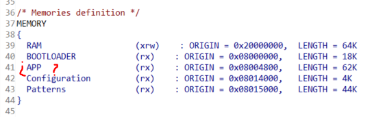

Once i tick the reference i want, how do i tell the linker what is what, any name convention i should know about?
2021-06-17 3:47 AM
You mix two things, and answer depends on your needs, Add in linker settings path to folder containing bin file, linker will search this file like library files.
This bin file can be anyware, copy to app project, use boot project location etc. Referencing project is usefull in developing stage, when you need always include latest version of bootloader.
In linker script you need insert:
TARGET(binary)
INPUT(boot.bin)
OUTPUT_FORMAT(default)
you need to create section ale place in correct place in momory in this section:
.boot_section :
boot.bin
} > BOOT_MEMORY
