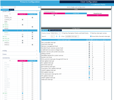

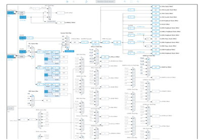

Pin and Clock Configuration
Clock Tree
NVIC1 Settings

2025-01-13 6:14 PM
Hangs where? If you stop the MCU in debugger where is it?
Hard Fault or perpetually locked in IRQ Handler trying and failing to clear the source.
You Erase a sector with live code in it?

2025-01-14 11:04 AM - edited 2025-01-14 12:40 PM
It hangs on this line
// CPU hangs when calling this function
HAL_NVIC_EnableIRQ(pSpiIoCfg->IntrIrq);
The interesting thing is when I step through debug the MCU, it does not hang on this line and this is true for both STM32CubeIDE and VSCode's Cortex-debug extension with our cmake project.
Oh I see this is a good point, I will try to see if I can catch a hard fault or stuck in an IRQ handler without the debugger with the user led
No, the sector is cleared with 0xFF
Sorry derp, yes the sector has live code in it as in our application code lives in that sector. So just to broaden the context here, we need to clear this sector to prepare for an incoming firmware image to be written to that sector.
