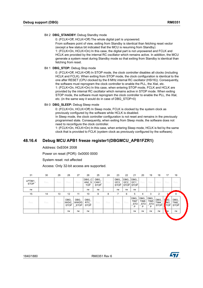

2021-11-06 6:14 AM
Timers continue to run when execution is paused in the debugger by default. You can adjust that behavior in the DBGMCU freeze register settings.
2021-11-06 8:22 AM
Even then, and even if you single-step, executing code which reads out TIMx_CNT may/will happen while the timer is running between steps, whereas the debugger reads it afterwards, so the values may/will differ.

being new to this tool suite can you point me to DBGMCU freeze settings location.....Somewhere under Properties- Run/Debug Settings?

This is a normal peripheral register bit.
Maybe there's some setting to set these bits from inside the debugger, I don't know what debugger are you using.
2021-11-06 11:22 AM
Oh you are suggesting it is a bit in a register on the target? I thought it was a switch somewhere in the CubeMX IDE...
I am using a STLINK V3 SET

2021-11-06 11:26 AM
Got it:thumbs_up:...will give it a try...
Thanks to all for the help
