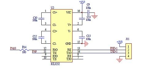

I have a graphic routine that show life on an lcd. it runs before the USART init (your example) and it shows ok on the LCD. I even added an ICL3232 to amplify and stabilize PA9 - but I still see nothing on Pin14...

What do you suggest? By the way I can validate that your code is correct since i found similar code on the ST site ... So I guess the problem may be in the vector init or somewhere along those lines ...2011-05-17 4:45 AM
