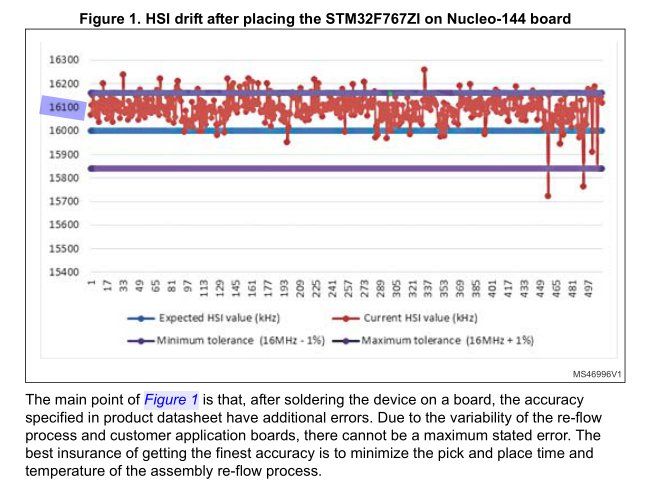

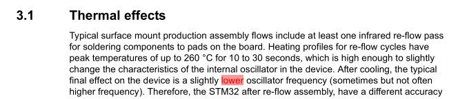

Followup snafu from reading more about this issue (new to me, fascinating):
From AN5067: How to optimize STM32 MCUs internal RC oscillator accuracy
but later in the document
so, you have a graphic of results showing the oscillator frequency is higher (mean of 16.1khz instead of 16Khz),
but the text states the thermal stress causes the frequency to drop. Unless I'm misunderstanding something (which happens), this is a contradiction.
...or to rise (half a sentence later).
PS it's 16MHz not 16kHz

@waclawek.jan wrote:> but the text states the thermal stress causes the frequency to drop
Come on. They say "typical effect is lower freq, and sometimes but not often higher freq" and they show 500 sample points from a test, 95% of which are higher in frequency. There's an obvious contradiction between text and data there.
right you are.
IMO it's not about the deviations of individual frequency readings, but the average, in one specimen. The "typical effect..." etc. means, that the temperature shock during soldering shifts the frequency irreversibly, and in most chips the HSI's average frequency is lower than it used to be before soldering. The shown example is that less common case, where the average is higher. And what.
The point is, that this effect is something ST discovered quite recently, some10 years after the chips are in manufacture. It's quite understandable: ST does not use them soldered. So they fixed the table with the footnote, but forgot to fix the text in narrative (which you rightly expect to be fixed, too; but there are much worse things in the docs. Doing docs properly is very hard and very expensive. I'm the last person to defend sloppiness in ST's docs, but these things have to be acknowledged, too.)
PS. One thing worthy of noting on that picture is, that the HSI frequency is fluctuating. It means, the 1% is not just an "initial deviation", but also includes a certain amount of that "permanent fluctuation" (in more serious setting we would talk about jitter, although that's just a fancy yet usually very vaguely defined term, too). And that's entirely uncharacterized, and for a good reason.
[EDIT] I misinterpreted that figure [/EDIT]
This sounds like a real stretch. So what you're saying is that when the chips come out of the factory, chips which ST engineered so that the spread is centered around the target nominal frequency of 16Mhz, 95% are even more than .1Mhz above the spec, so that soldering actually makes them better? that's a definition of "typical value" I've never heard of.
Also, look at the captioning (or is it text) right below the graph in the image i posted. "after soldering, Additional errors" and they say soldering effects are unpredictable, so I doubt they design this deviation in on-purpose so customers can dial it just so with the available calibration range. That would be mad. If that were true that would mean that if someone takes great care during assembly (as ST recommends in the text) they would get *worse* results on average without calibration.
