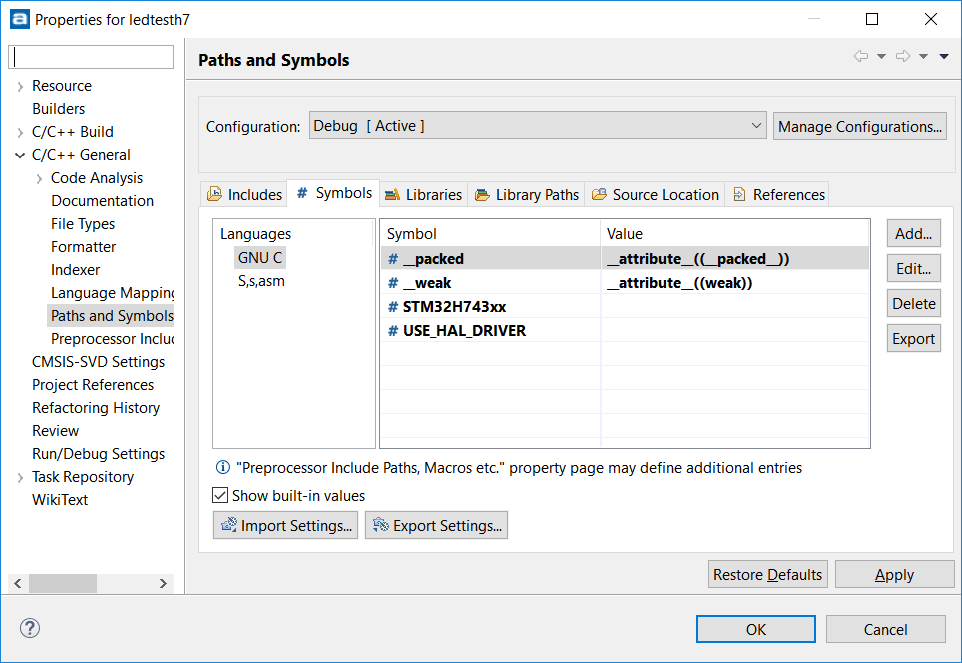

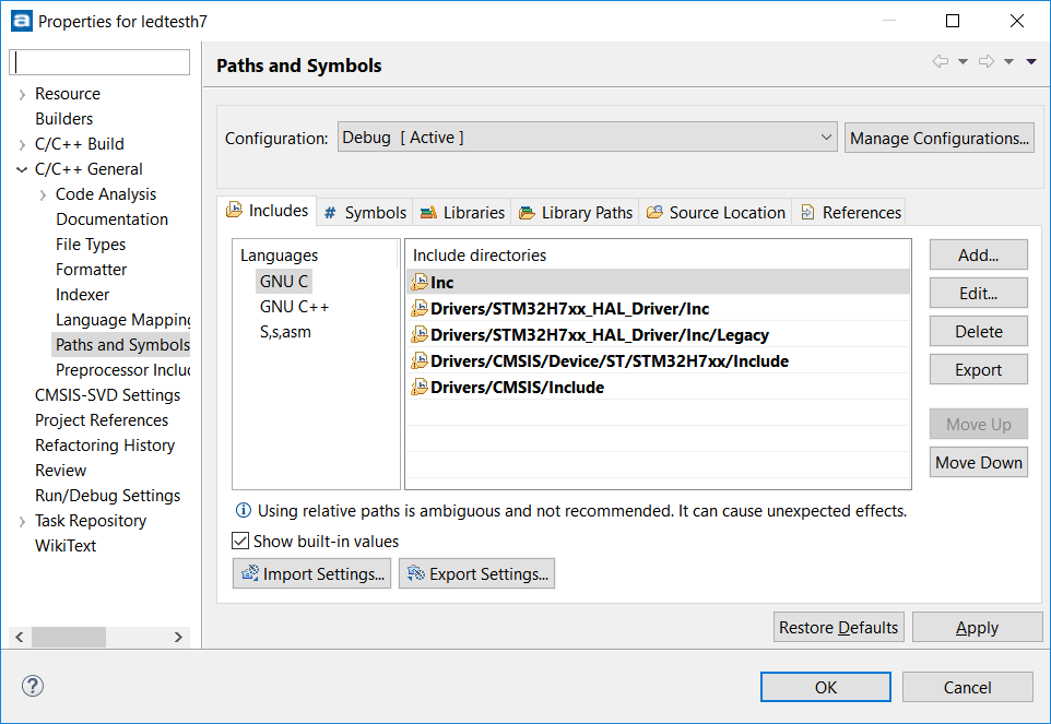

From various sources, I got hints how to do. I fail when trying to copy the symbols e.g. processor type to C++ because the input pane is missing. Here is in detail what I tried so far:
When I create a C++-Project directly using Atollic, there are entries for GNU C++ on both the includes and the symbols tab.
I tried to figure out what was the difference between both .project and .cproject files.
In both .project-files, the org.eclipse.cdt.core.ccnature is present
In the .cproject of the native Atollic-project, I see the entry for my symbol:
<tool id="com.atollic.truestudio.exe.debug.toolchain.gpp.165402641" name="C++ Compiler" superClass="com.atollic.truestudio.exe.debug.toolchain.gpp">
<option id="com.atollic.truestudio.gpp.symbols.defined.287854650" name="Defined symbols" superClass="com.atollic.truestudio.gpp.symbols.defined" valueType="definedSymbols">
<listOptionValue builtIn="false" value="STM32H743xx"/>
</option>In the project migrated from CubeMX, I see the same options, however they are populated with nonsense values and they seem to be ignored:
<tool id="com.atollic.truestudio.exe.debug.toolchain.gpp.981298185" name="C++ Compiler" superClass="com.atollic.truestudio.exe.debug.toolchain.gpp">
<option id="com.atollic.truestudio.gpp.symbols.defined.1619552487" name="Defined symbols" superClass="com.atollic.truestudio.gpp.symbols.defined" valueType="stringList">
<listOptionValue builtIn="false" value="STM32F10X_MD"/>
<listOptionValue builtIn="false" value="USE_STDPERIPH_DRIVER"/>
</option>Does anyone has any clue why Atollic does neither display those values nor use the during compilation?

at least for the projects generated by CubeMX, Symbols is the way to go as this is how they do it for plain C projects.
In the meantime, I went one step further: You already see in my post that for example the block for C++ looks different, i.e. valueType is "stringList" for the C++-block, whereas valueType is "definedSymbols" for the C-block. I tried to change this without success, however, just copying the C-block and change all gcc to gpp got me a working project. I further digged into this and found out that CubeMX generates this block already although this is not a C++ project and it looks like this block present confuses Atollic during the convert to C++ and later on.
So far I have not found out whether simply ommiting this block in the CubeMX-template would be sufficient to prevent this issue. If this was the case, this would be a fix that ST should definitely consider for the next release.
2018-10-21 9:05 PM
To edit the symbols for the C++ language go to:
then copy the exact symbols from C Compiler.
After I did this my project compiled correctly.
I hope it helps.
