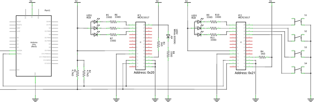

update: the error is caused by this line specifically:
~code from the driver:
/* Send Slave Address and Memory Address */
if (I2C_RequestMemoryWrite(hi2c, DevAddress, MemAddress, MemAddSize, Timeout, tickstart) != HAL_OK)
return HAL_ERROR;
so it's not even communicating properly as a slave. my set-up Is very similar to this one below (I only have one led hooked up to one of the three mcp extenders I have... I don't think it's the connections - I think I am not sending the signals properly/configuring things the right way. I am very new to stm32 so thank you for still helping me out!
