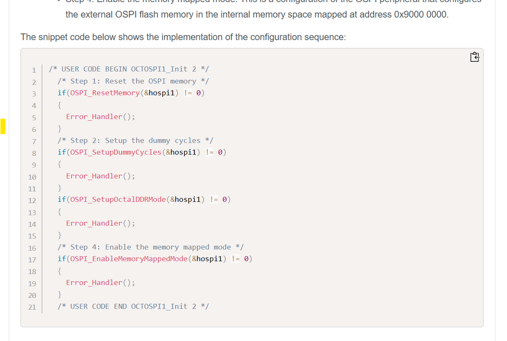

I advice you to check this sequence, it’s common that the application needs to configure the memory device. An example of a commonly needed configuration is presented below:
1. Set the dummy cycles according to the operating speed (see relevant memory device
datasheet).
Note: The dummy cycles of the STM32 MCUs are equivalent to the latency term used by the external memory side.
2. Enable the Octo-SPI mode or 16-bit mode.
3. Enable DTR mode.
