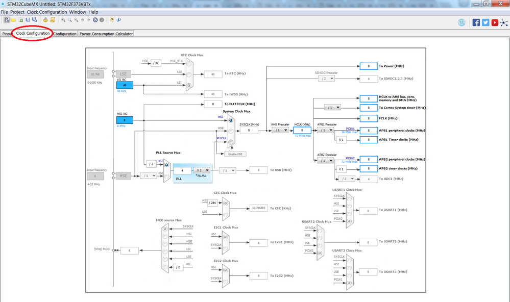

Hi
mk912a
,Iadvise you to use the
tool. It embedsa clock-tree setting helper.
After generating your project (using your preferred tool chain), the ''main.c'' file will contain a function named ''SystemClock_Config'' where the system clock is configured.
