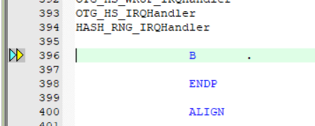

2021-09-08 2:04 AM
the program gets stuck here
