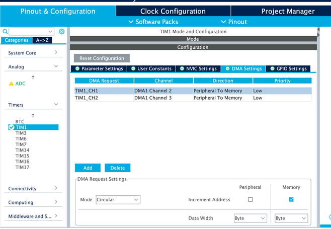

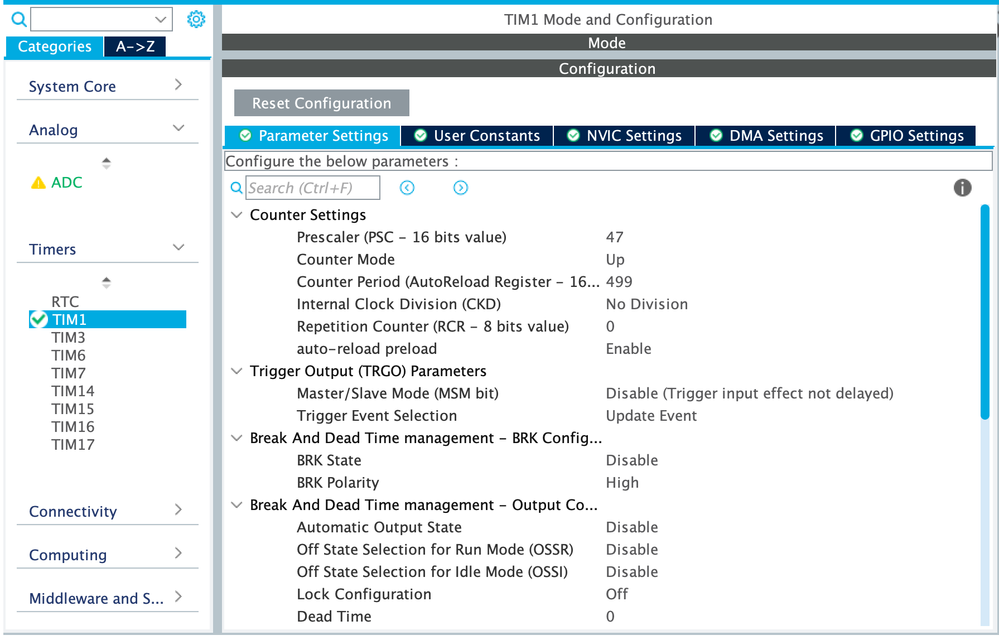

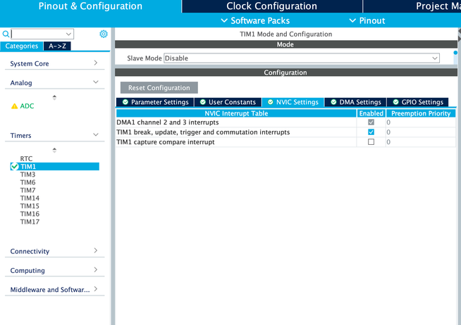

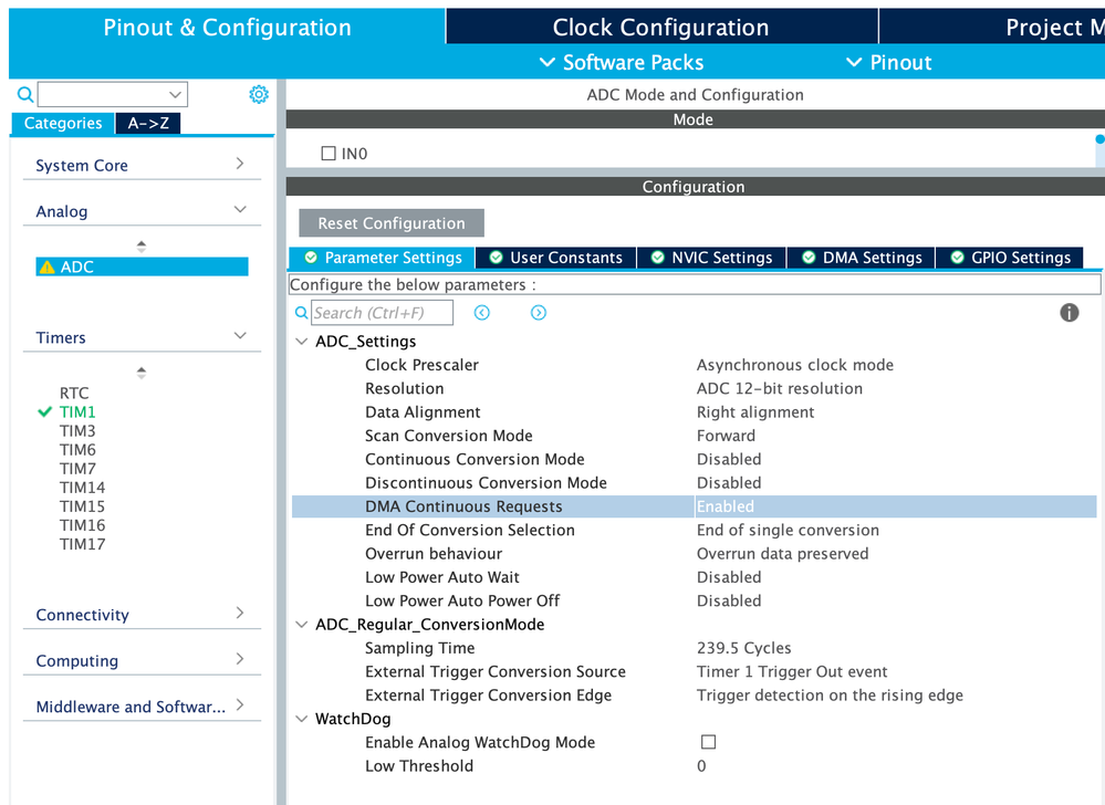

I want to make 4 channel PWM signal using TIM1 (with complimentory also) .While the TIM1 is used to triger the ADC to get sample .
I am getting the pwm wave , But ADC is not triggering or not working . What configuration i require
Please see more details below
I am Trying to generate 2 Channel PWM Genertaion [ CH1 CHN and PWD Generation CH2CH2N ] from DMA Buffer .
HAL_TIM_PWM_Start_DMA(&htim1, TIM_CHANNEL_1, (uint32_t *)sin_table, 160);
HAL_TIMEx_PWMN_Start_IT(&htim1, TIM_CHANNEL_1);
HAL_TIM_PWM_Start_DMA(&htim1, TIM_CHANNEL_2, (uint32_t *)sin_table, 160);
HAL_TIMEx_PWMN_Start_IT(&htim1, TIM_CHANNEL_2);
Configuration as follows
While PWM generation am trying to TIM1 is to triger the ADC
The ADC configured as follows
HAL_ADCEx_Calibration_Start(&hadc);
HAL_ADC_Start_DMA(&hadc, (uint32_t *)ADC_RES, 200);
Am here attached the main.c file

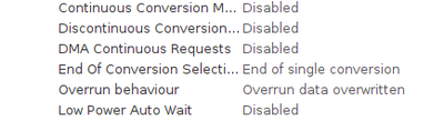

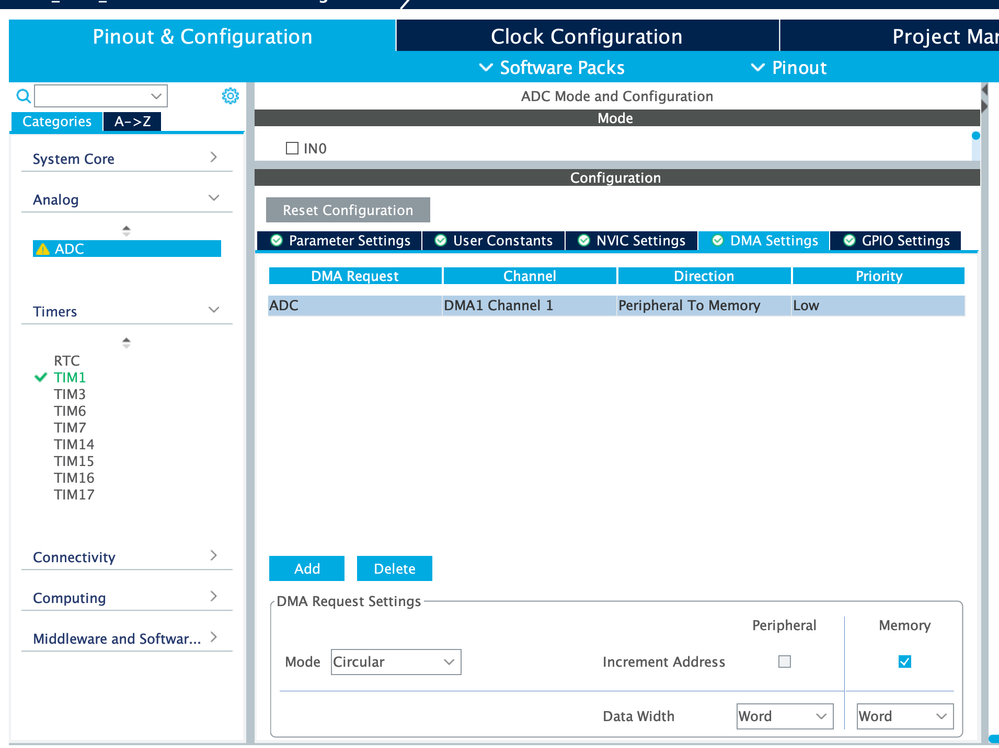

2024-04-26 4:01 AM - edited 2024-04-26 4:03 AM
just what i see now : not enable continuous..
adc...dma:
see my use case : tim8 -> trigger -> adc (with dma )
tim8:
adc:
start in main.c : (but i use not circular dma here, doing just one 512 sample-shot.)
retval = HAL_ADC_Start_DMA(&hadc1, (uint32_t *) &sampels[nu][0], 512);
while(HAL_DMA_GetState(&hdma_adc1) > HAL_DMA_STATE_READY) {}; // wait for ready

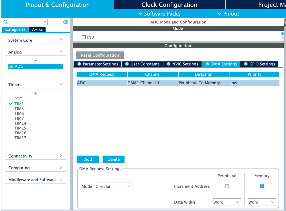

2024-04-26 4:31 AM - edited 2024-04-26 4:41 AM
I tried DMA continuous. request turned off ?
If circular mode turn off is it restart from zero after 512 ?
Other configuration is correct in my case ?
In the below code i didnt get the trigger in GPIOC Pin4 what is the wrong with me ?

2024-04-26 4:48 AM - edited 2024-04-26 4:51 AM
Just try it.
Yes, without circular mode : just filling the array one time. (Same as "one shot" on a DSO .)
Next dma start...same again.
Hmmm...try. If you want continuous operation, then circular mode is correct; you have to use/copy data then in half/full callbacks - or just let it run. Only one dma-start needed here, it will loop always/endless and fill the array.
