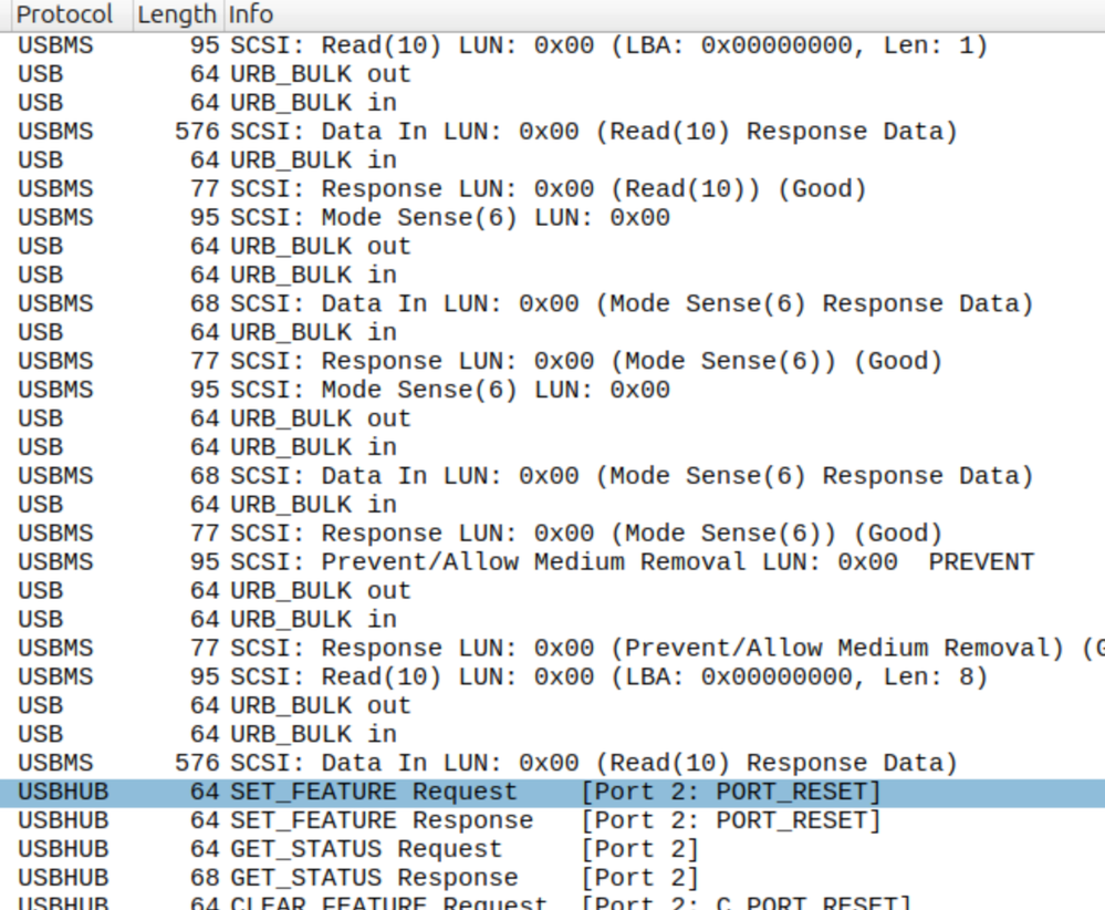

On Wireshark we can see that host (PC) ask to read Len:8 that means 8*512 =4 096 and the firmware answer with a 576 data packet. So host reset the usb because he doesn't like the answer.
My issue was a SD read issue not USB.

I look communication with Wireshark and it's like firmware stop responding et communication restart. I don't understand why.
