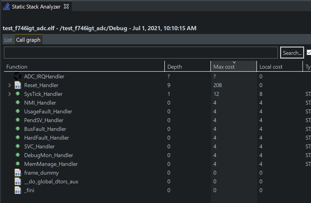

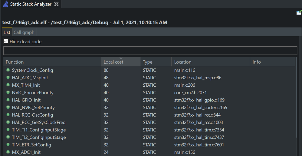

You can use the stack analyzer in STM32CubeIDE to verify you're within whatever limit you set.
There's no runtime specific check that can be done here.
The call graph based usage is especially useful:
2021-07-03 10:12 AM
> So the only way is to use malloc and check for a valid pointer?
Malloc uses the heap, while defining a local variable uses the stack. They are different pools, but share the same space. Even if you get a valid pointer back from malloc, it could still be overwriting variables on the stack.

> Anyways, how do I know if the system ram has enough space for it?
You manually check that the sum of the "max cost" of all IRQs that can be called at once is less than what you have allocated for your max stack size.
The call graph includes overhead for functions called by other functions. For example, Reset_Handler includes stack used by main(), as well as functions that main calls, and so on...
