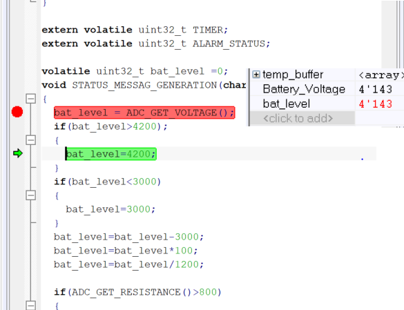

}MY latest problem I was generating string from battery voltage;
bat_level = ADC_GET_VOLTAGE();
if(bat_level>4200);
bat_level=4200;
if(bat_level<3000)
bat_level=3000;
bat_level=bat_level-3000;
bat_level=bat_level*100;
bat_level=bat_level/1200;And I always get 100%, even if my voltage is 3300 ( 1bit = 1mV)
And when debugging this part of code showed me why, I always make if compare and set 4200mV !!!

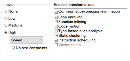

How is this possible? What I am doing wrong. (new iar arm compiler 9.10.2 with optimization on)

You have a semicolon at the end of your if statement. It always forces bat_level to change to 4200.

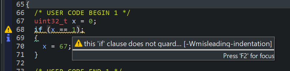

The best defense against obviously incorrect but technically compileable code is an IDE that detects these types of mistakes.
Both CLion and STM32CubeIDE detected your syntax was not intended.

It's already converted to correct volatge by DMA_TC interrupt callback. so it is down to 1mV precision as with multi-meter reading
All ADC_GET_VOLTAGE() does is return value of global variable inside adc program that runs on TC IRQ's
Problem is with scaling logic not been corectly executed based on what I write. it works ok with zero optimization.
First bat_level was declared inside function, it give same results, when made it global, after that volatile, no results...
2021-06-14 10:46 AM
Ok, now I see the problem. simple mistype after if() ;
After complete day of coding you start to miss mistakes like that.

Ususally it's optimization problem and inability to see that I use variable that looks to be unused. Last time it happened was with timer, i was unable to read TIM2->CNT register to variable, it always stayed 0. Reason, it was optimized out, while it was used to extend 16b counter overflow for 32b emulation.
With it was working with no optimization.

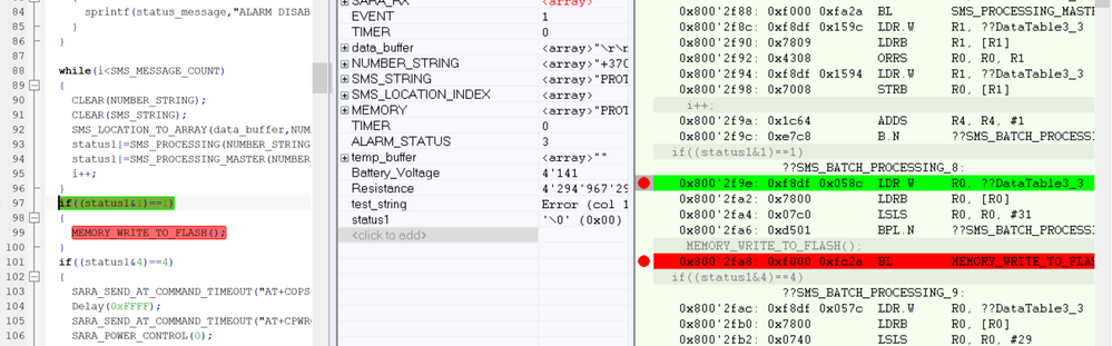

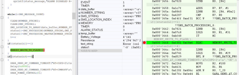

2021-06-17 12:13 PM
This is another example. Even if status is 0, and I can check it with debugger, it always goes inside if true condition, and updates my flash from ram.
This is with high optimization, no matter what I do, it allays does that...
with no optimization works just fine !
So where is my mistake ?
