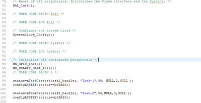

Hello everyone,
I am using NUCLEO-F410RB Board embedding STM32F410RBTx Device and I was trying to port the FreeRTOS bare minimum(kernel w/o CMSIS) api here and it is throwing me an error when I create a bare minimum task(no global variables or arrays in the main either.)
Note: It is building properly when I am not using the FreeRTOS Apis.

Any thoughts on what is missing over here?
2024-08-10 7:08 PM
Use the Build Analyzer -> Memory Details tab to find what is using all the space.
2024-08-10 7:23 PM
Thank you so much for the response.
This is the Build analyzer w/o calling FreeRTOS tasks, but when I add tasks in to main.c, the code is not even compiling, so I am unable to analyze how much space is occupied.
@TDK Can we use Build analyzer with out actual elf or executable?
2024-08-10 7:54 PM
I think you need an ELF to analyze.
Edit the linker file to increase the size of the ram, then compile it, then see what's taking up so much space.
2024-08-10 8:21 PM
Hey!! @TDK
Actually heap_4 was taking so much memory in my 32KB system that I ha to limit the heap to minimal size.
I modified the FreeRTOSConfig.h and it is compiling now for gods sake!!
