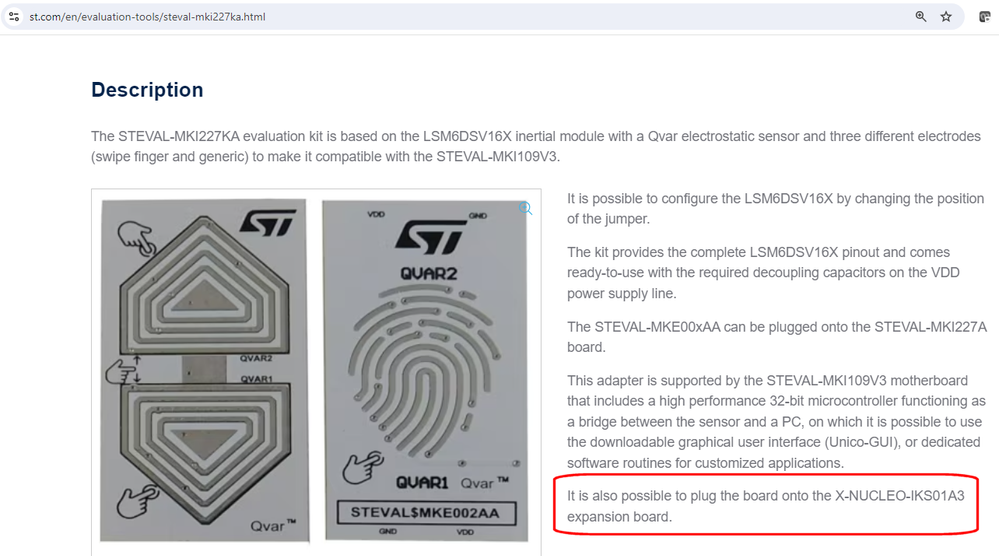

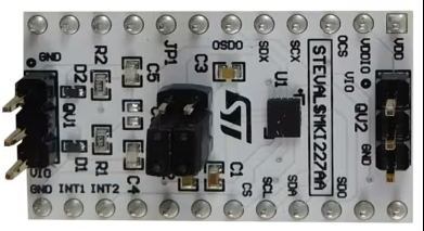

Thanks for clarifying this issue. I have one more question, is the STEVAL-MKI227KA physically compatible with the NUCLEO-H503RB in terms of pin connections?
2024-08-06 2:44 AM
You'd have to look at the schematics for that.
But the STEVAL-MKI227KA is a standard DIL 24 package:
https://www.st.com/en/evaluation-tools/steval-mki227ka.html

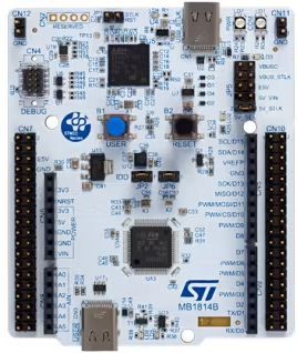

The NUCLEO-H503RB doesn't have a DIP-24 socket on it:
https://www.st.com/en/evaluation-tools/nucleo-h503rb.html
So you're going to have to use flying leads, or make/buy an adaptor; eg,
