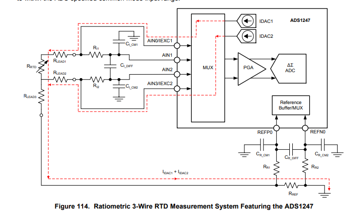

2023-04-03 2:56 AM
R14 ... seem useless in this position, except wasting some current.
2023-04-03 8:15 AM
The value of resistor is 820 ohms as requed by data sheet. And schematic also from it. I trying to figure out what can be wrong.
2023-04-03 9:15 AM
should be this ...?
2023-04-03 9:25 AM
Yes this is 3 wire connection of RTD PT100. Any way it's not working even in 3 wire mode.
I have changed Rref from 820 ohms to 4.7 kohm and value unpredictable and jumping...
2023-04-03 9:30 AM
