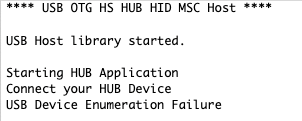

Here’s the example I’m working with.
However, if HSI48 can be used with an external PHY, then I won’t worry about it anymore.
I’m currently running the ux_host_hub_hid_msc example (v3.3.0) for the STM32H747I-DISCO board, and I’m encountering an issue when enumerating a USB MSC device, it fails right after plugging it in.
I’m using USBX.
At first, I suspected the problem might be related to the clock configuration, but as you mentioned, that shouldn’t be the case…
What should I do?
