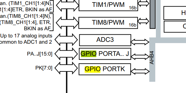

2023-01-13 7:15 AM
Hello @pk84 ,
The GPIOC and GPIOF are mapped on the same bus and no problems with the STM32H750 Disco
Try to verify your PCB .
Foued

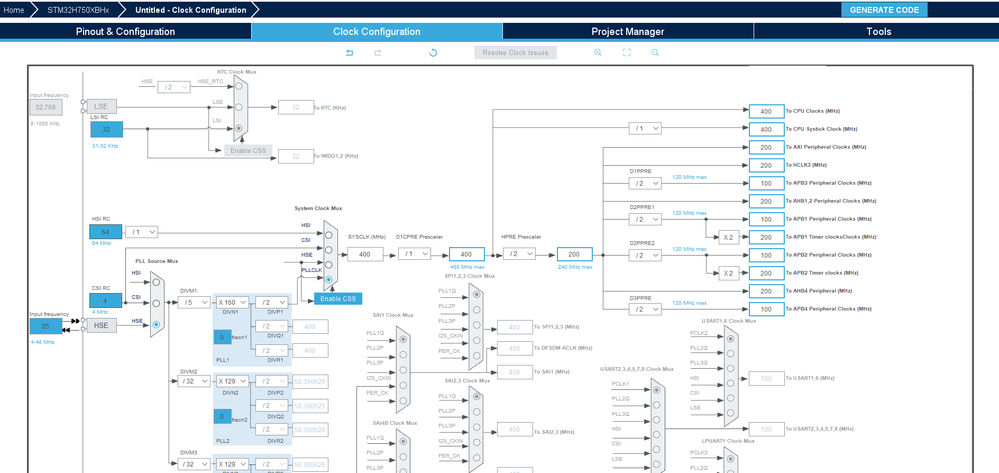

2023-01-13 7:42 AM
Well, I don't see anything blinking with 600 ms in any video.
Maybe check your SysTick generation, which is used by HAL_Delay (I think).
But you see that the "working version" runs on a 216 MHz clock, the other version with 400 MHz ?
