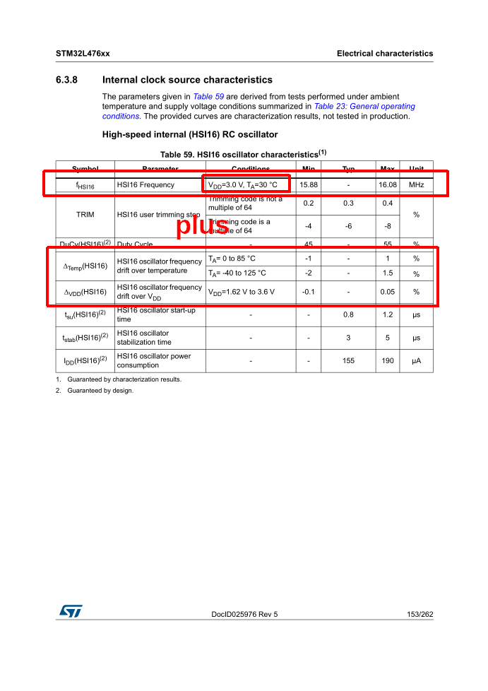

2023-05-22 9:55 AM
> PLL can modify the accurate no?
No. PLL can add jitter, but the long-term relative accuracy (i.e. how many % is it different from the required frequency) is the same as of the primary clock source (i.e. here HSI16). Same for timer, which is derived from PLL.
By multiplying (as in PLL) or dividing (as in prescalers and dividers) you can't change relative precision of frequency. You can increase precision by introducing some external, more precise source - either by calibration of the HSI (but don't hold your breath, it won't be too precise even after calibration, see trimming step in the above screenshot) or simply by deriving the frequency from a more precise source, i.e. crystal or crystal oscillator.
