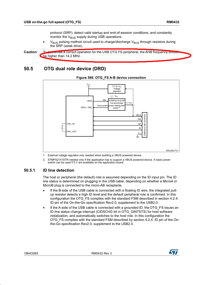

In the clock tree configuration for the STM32L4R5ZI the CubeMX tool only allows for frequencies >14 MHz for the HCLK subsystem. For lower clock frequencies the HCLK window is marked in red (illegal configuration).
In the Microcontroller datasheet, however I find data (e.g. regarding power consumption) also for frequencies as low as 100 kHz.

You told CubeMX you want to use USB, didn't you?

Not intentionally. But you are right. Actually, this seems to be activated by default when generating the project from scratch for the NUCLEO-L4R5ZI board. I just checked it. After switching the USB peripheral off, everything worked as expected and as I know it from the other chipsets.
