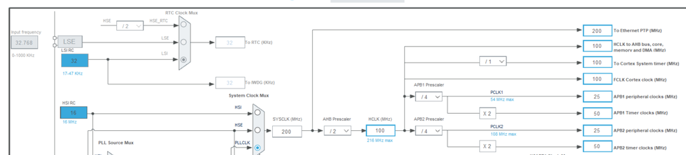

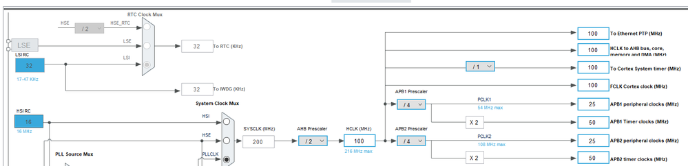

I updated my stm32 project because I had problem on the older version. So I updated the Time.ioc by migrating version...
...but when I open the system clock configuration I see that it's not the same configuration for "To Ethernet PTP". For information I'm working on a STM32F769BGT6.
Old version :
New version :
Id'like to know if it is normal or not, and if I can change it to have the same configuration as the old version ?

2024-04-05 2:50 AM - edited 2024-04-05 2:51 AM
It was a mistake in the old version of CubeMx and in the documentation (reference manual).
See this thread.
