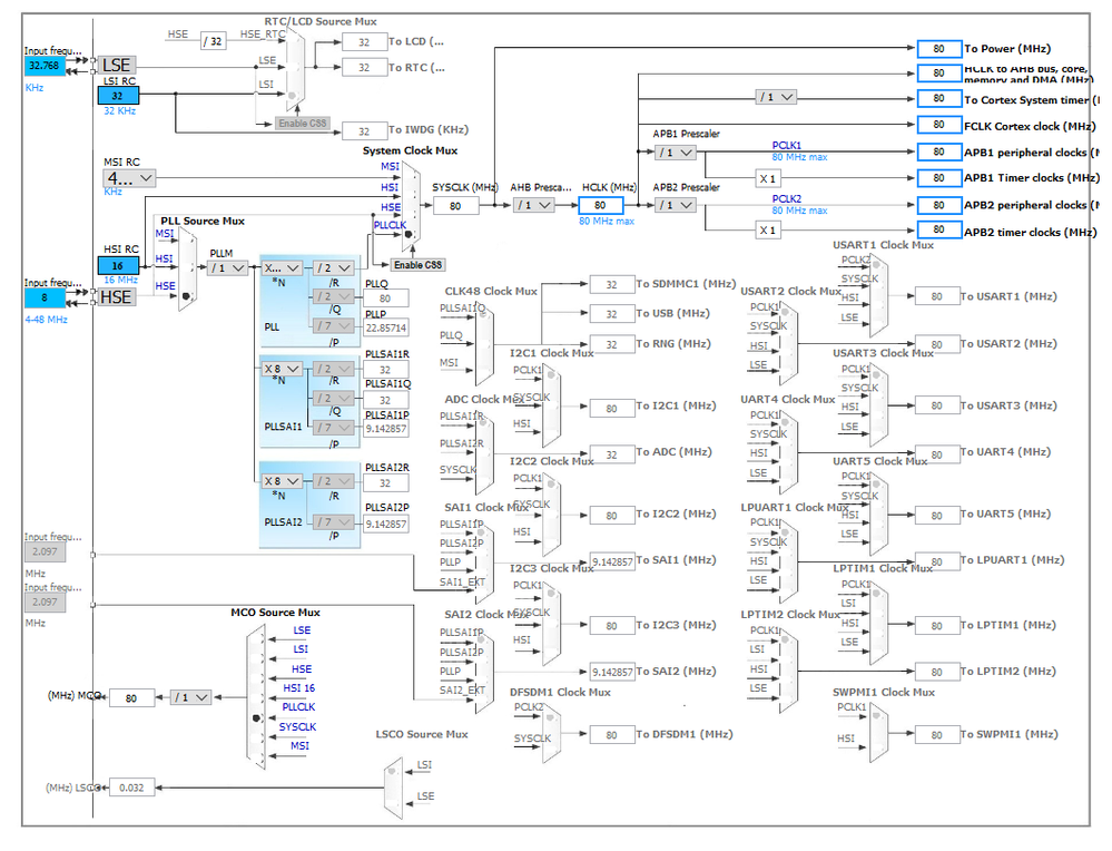

I configured the clk as shown on the picture below

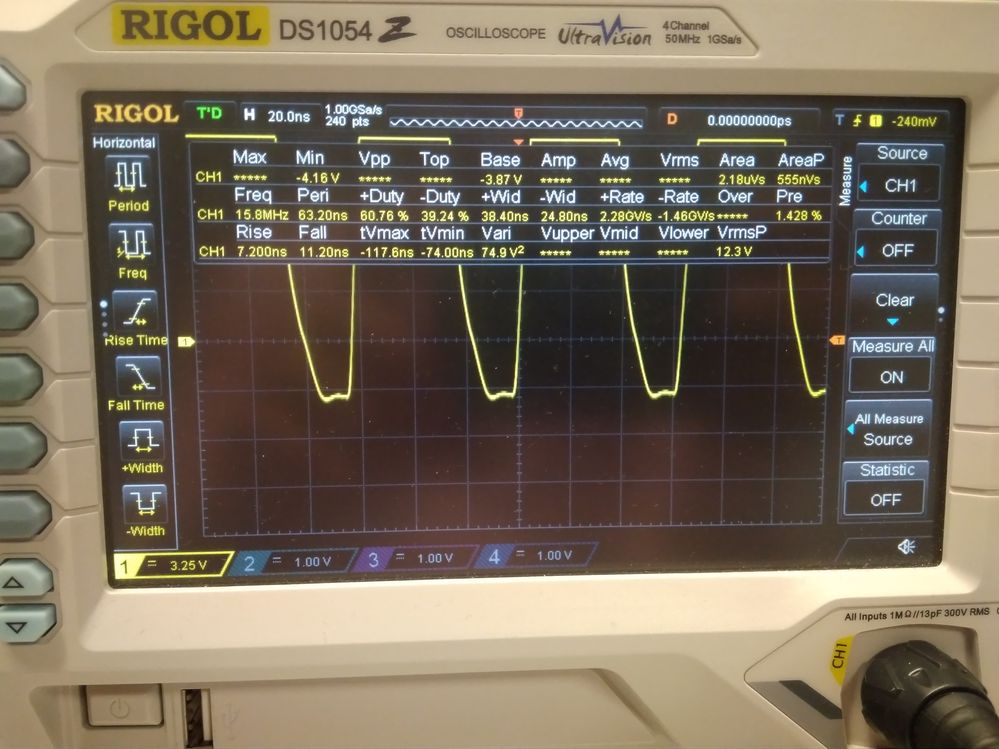

logically, I should obtain 80MHZ as an outpout frequency, but when I use the scope, it is
fixed
all of the time at 16 MHZ if I use MSI or HSE as shown on the picture below

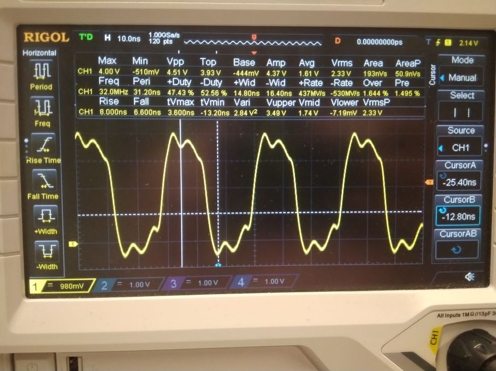

and it is fixed at 32 MHZ if I use the HSI,
I tried to use the different divisions /1, /8.. and the different clk (PPLCK, SYCLK, HSE...) to obtain the correct frequency, but everytime, I have the same frequency output that I showed on the scope,

Hello, you are either:
- facing the problem pointed by Jan,
- or your HSE oscillator is not working as expected and the clock falls back to HSI (because the CSS is enabled as per your screen shot)
There are many reason that could cause the HSE to fail.

Looking at your clock tree I assume that you work with STM32L4 MCUs family.
It could be that you faced CubeMX issue with code generation for clock domain. Could you please take a look on this thread:
https://community.st.com/0D70X000006SldESAS
? The issue described there is wrong PLLM parameter set by CubeMX.Regards

This is due to the lack of the PLLM configuration, it is a known issue and will be fixed next release.
As workaround you can use the LL driver for RCC code generation.
