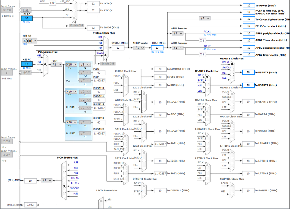

Hi, the problem is not solved, below is the clock configuration,
Based on the figure above,
I tried to use the different divisions /1, /8.. and the different clk (PPLCK, SYCLK, HSE...) to obtain the correct frequency, but everytime, I have the some frequeny output that I showed on the scope,HSI --> 16MHZ (correct value)
SYSCLK --> 32MHZ (wrong value != 10 MHZ)
PLLCLK -->

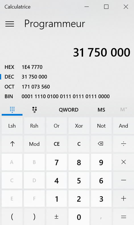

I added some instructions on the code to show the frequency value, and that gives 32MHZ as shown on the pictures below
