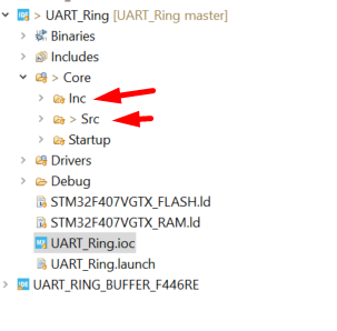

One question for you and I would be very glad if you could answer. I am using STM32F407VG-DISC1 board.
I have checked the repo you ve provided. I wonder that, is that OK if I copy ringbuffer.c under core-->src and also ringbuffer.h under core -->inc.
Then, can I use ringbuffer functions with ease ?
