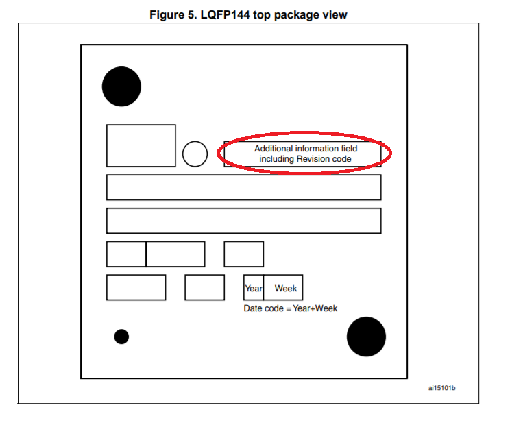

Regarding the revision you're using, you may have it using STLink utility tool or it's marked on the chip.
Khouloud.
2018-10-31 6:08 AM
I think this is a BGA package, the revision is marked after the year/week code, and it has already been clearly established what the part is reporting, which is consistent with that.
