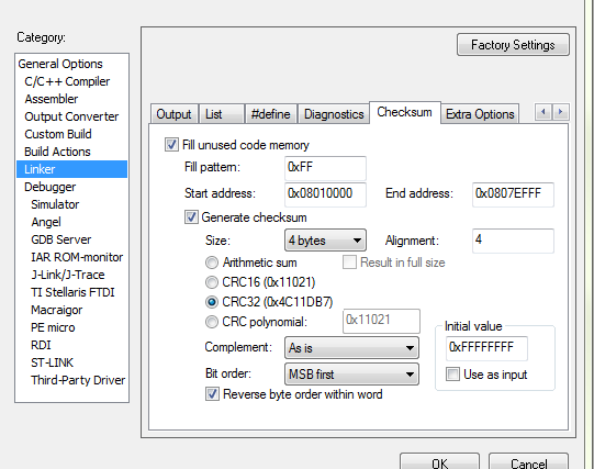

Here are the settings I used in IAR to get the checksum to match the STM32-generated one (note that your addresses will be different depending on your application):

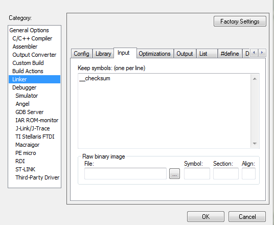

In ''http://supp.iar.com/Support/?Note=11927'' I don't understand what does mean ''add usage of the symbol......'' When I declare it as following:unsigned short __checksum; I got thsi error message:Error[Li006]: duplicate definitions for ''__checksum''; in ''C:\.....\checksum\Obj\main.o'', and ''Place holder __checksum'' When I declare it as following as done in the example provided by IAR:extern unsigned short __checksum; I got this error message:ielftool error: The string '__checksum' was not found in the string table How did you get off of it? Thank you MCU Lüfter2011-08-09 1:54 PM
Make sure you add the __checksum symbol to the Input dialog as shown below:
