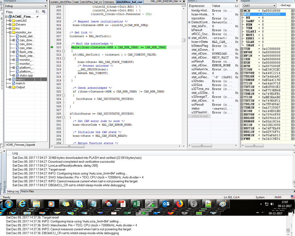

The code is entering the while loop and getting stuck there in stm32f4xx_hal_can.c file....the image for the same is provided below
