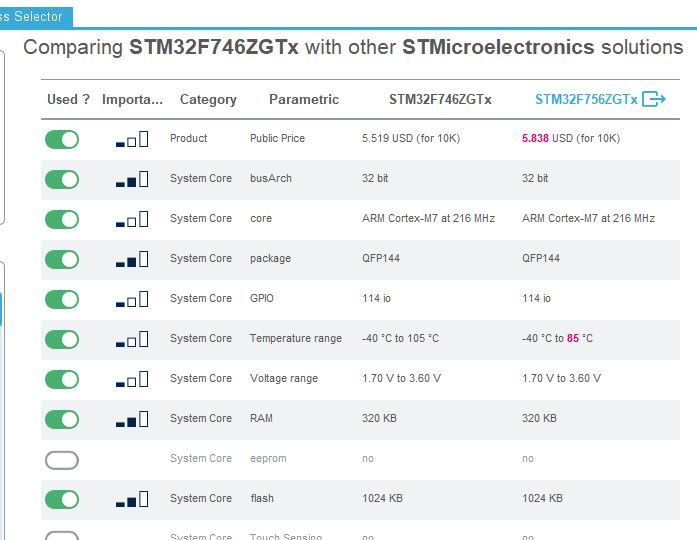

2021-10-18 12:29 AM
can you share the link for doing the comparison thanks ?
2021-10-19 2:32 AM
Using STM32CubeMX tool, through "Cross selector" feature.
For more detail, please refer to the "4.2.4 Cross selector" section in the UM1718.
Imen
