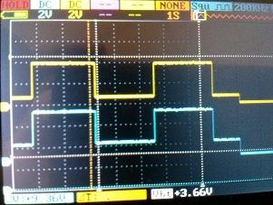

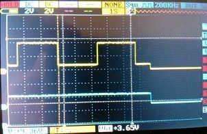

Of coure I also want your help!
Here my Problem in pictures:
void
TIM_test(
void
TIM_TimeBaseInitTypeDef TIM_TimeBaseStructure;
TIM_OCInitTypeDef TIM_OCInitStructure;
TIM_DeInit( TIM4 );
TIM_TimeBaseStructInit( &TIM_TimeBaseStructure );
TIM_TimeBaseStructure.TIM_Period =20000;
TIM_TimeBaseStructure.TIM_Prescaler = 10000;
TIM_TimeBaseStructure.TIM_ClockDivision = 0;
TIM_TimeBaseStructure.TIM_CounterMode = TIM_CounterMode_Up;
TIM_TimeBaseInit(TIM4, &TIM_TimeBaseStructure);
TIM_OCStructInit( &TIM_OCInitStructure );
TIM_OCInitStructure.TIM_OCMode =TIM_OCMode_Toggle;
TIM_OCInitStructure.TIM_Pulse = 20000;
//When a match is found between the capture/compare register and the counter
TIM_OCInitStructure.TIM_OutputState = TIM_OutputState_Enable;
TIM_OCInitStructure.TIM_OCPolarity = TIM_OCPolarity_High;
TIM_OCInitStructure.TIM_OCIdleState = TIM_OCIdleState_Reset;
TIM_OC3Init(TIM4, &TIM_OCInitStructure);
TIM_OCInitStructure.TIM_OCMode = TIM_OCMode_Inactive;
TIM_OCInitStructure.TIM_Pulse = 20000+1;
TIM_OC1Init(TIM4, &TIM_OCInitStructure);
TIM_ITConfig(TIM4,TIM_IT_CC1,ENABLE);
TIM_Cmd(TIM4, ENABLE);
I use the toggle mode to output a waveform on TIM4_CH3
And TIM4_CH1 to generate an interrupt.
so I have 4 scenarios: The question is why is there a pulse in scenario 4 on CH1??
CH1_Pulse = 20000
CH3_Pulse = 20000
CH1_Pulse = 10000
CH3_Pulse = 20000
CH1_Pulse = 20000
CH3_Pulse = 20000+1
CH1_Pulse = 20000+1
CH3_Pulse = 20000
2014-02-07 5:24 AM
This is a feature (*).
RM0090 rev.5 p.619, ch.18.4.5 - description of TIMx_SR.CC1IF: When the contents of TIMx_CCR1 are greater than the contents of TIMx_ARR, the CC1IF bit goes high on the counter overflow (in upcounting and up/down-counting modes) or underflow (in downcounting mode) JW (*) if (Surprising()) { if (Documented()) { IsAFeature(); }else { IsABug(); }2014-02-07 5:31 AM
Thanks
