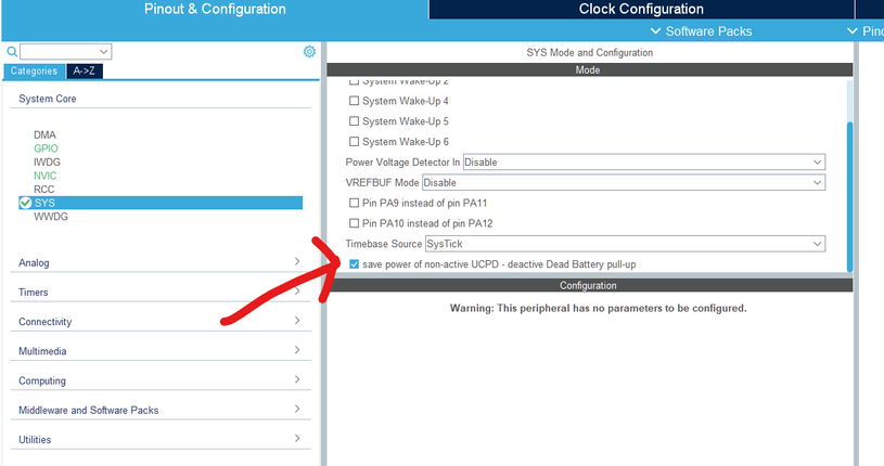

Hey All,
I cannot seem to uncheck the option "save power of non-active UCPD - deactive Dead Battery pull-up"
Everytime I generate code I have to manually comment out (disable) (HAL_SYSCFG_StrobeDBattpinsConfig(SYSCFG_CFGR1_UCPD1_STROBE | SYSCFG_CFGR1_UCPD2_STROBE);)
to make it work
Kind Regards,
Sparsh

STTwo-32
Hello @s_bhonwal
Thank you for reporting this issue. I've been able to reproduce it and i will escalate it to the concerned team for correction (under internal ticket number 177884).
Best Regards.
STTwo-32
STTwo-32
Hello @s_bhonwal
This issue is solved on the new release of the STM32CubeMX (V6.12.0).
Best Regards.
STTwo-32
