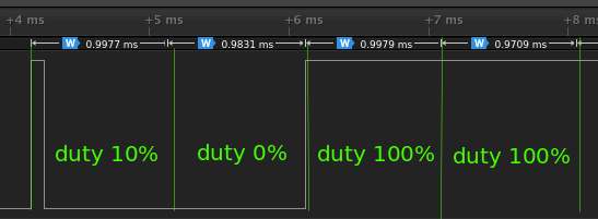

The problem is two 100% duty pulses generated when I give only one pulse.
Could you tell me the cause and how to solve this problem?
