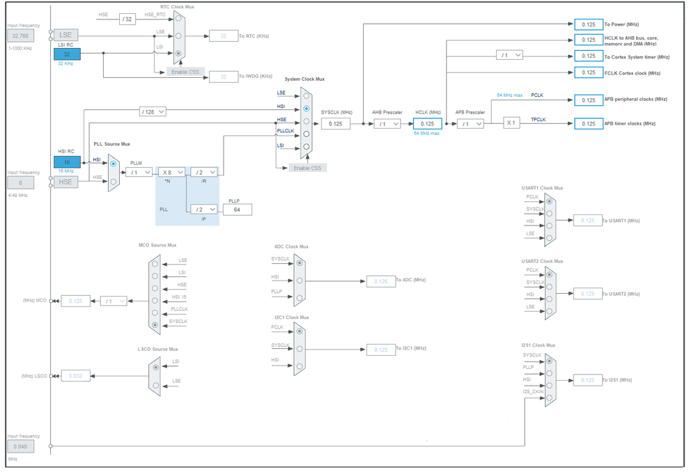

The attached is my clock config:

I think the overconsumption you are observing is most likely coming from the HSI16MHz oscillator itself, which is ON in your experiment, but OFF in DS values (the HSE Bypass is used in that case to clock the device).
The intrinsic consumption of the HSI is around 150uA so that would fit approximately the results.
Let me know if you can check this by disabling it and trying to clock this MCU in HSE bypass mode for example?

I tried to turn on the bypass mode with my existing board, but I did see much change. Probably it is due to I do not have an HSE at all.
If my understanding above is wrong, please correct me and point me the right direction.
