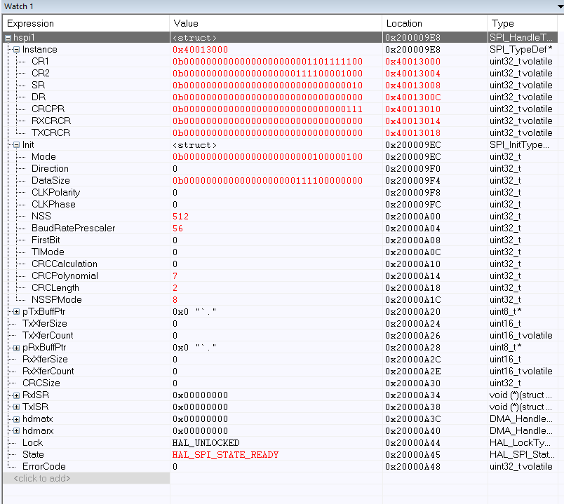

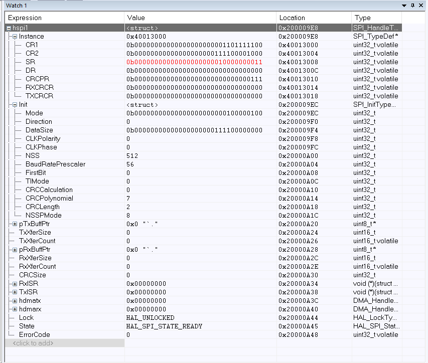

2020-05-22 12:07 PM
Just before while 1 after spi init
after 1st LL_SPI_TransmitData16 call, breakpoint on ubNbDataToTransmit--.
Not real sure how to read/show the relevant GPIO regs.

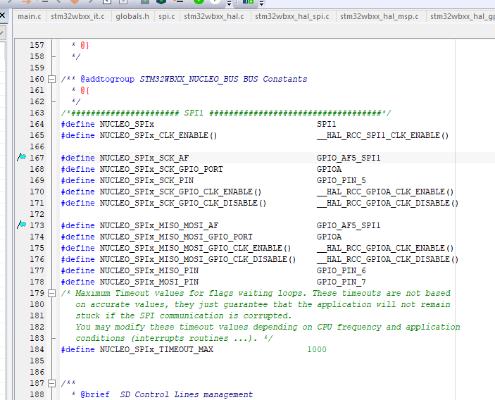

2020-05-22 1:55 PM
Could this be the issue? This is from header file stm32wbxx_nucleo.h. Do I need to redefine from GPIO A to GPIO B here and the relevant pins?

The binary numbers are extremely hard to read, next time please use hexadecimal.
GPIO_MODER looks good, AF set for PB3, 4, 5; but you did not post the AFR register's content.
SPI registers look good, the fact that RXNE is set after the transmit function makes me believe that the clock is output to physical SCK pin (otherwise the receiver in other STM32 SPIs does not work; I doubt the 'WB is an exception).

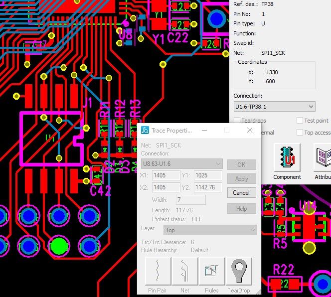

Did you observe the pins directly on the package? Isn't there a jumper or solder bridge on the board which you overlooked? See schematics and board manual.

Ok, I took the same CubeMx file and disabled spi1 and made PB3,4,5 outputs so I could toggle them. I added the code shown below

And on the test points on the board I measured the following on PB3, 4, and 5. I’ve ohmed each pin to each other plus to ground and surrounding pins and no shorts so I’m confident the hardware is ok.
