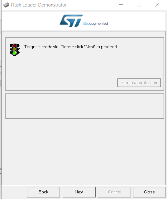

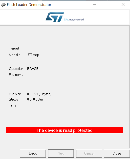

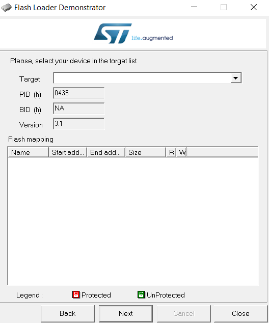

Finally after a long struggle, I was able to get into the system memory by changing to CP2102 ttl wire. Now I have another problem. Any solution to fix this?
The PCROP_PDP bit is unchecked also.
