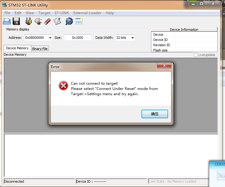

I could not connect the target (STM32F103ZET6) through ST-LINK or j-link(Both emulators are work well on other demo boards).
The MCU is powered by at 2.7V. Strangely , I've checked all the connections of the SWD interface and they seems ok. A 10kR pull-down was connected to SWCLK and a 10kR pull-up was connected to SWDIOI put the probes on the SWDIO and SWCLK signal(CH1:SDIO,CH2:SWCLK,CH3:VDD) and the SWDIO waveform look very strange. It seems it can not be pull down to zero in some period but not all the time.Removing the pull-up resistor on SWDIO also doesn't help!Is anyone see this before? The MCU is a brand new one and I believe should be no program on it.2015-05-14 8:20 AM

It's a low level error. Just realized that the VADDA was unconnected.The problem has ben fixed now.
